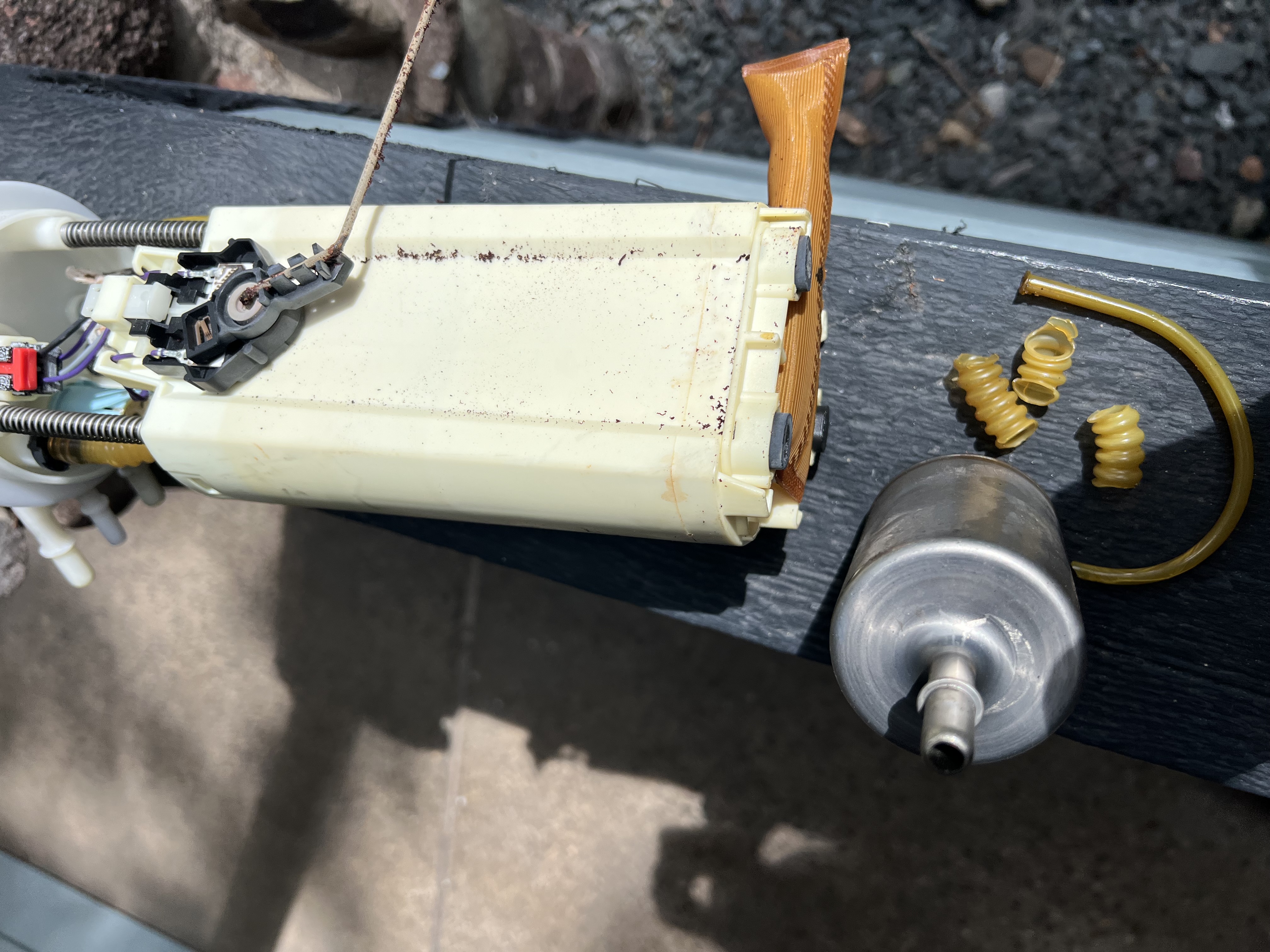

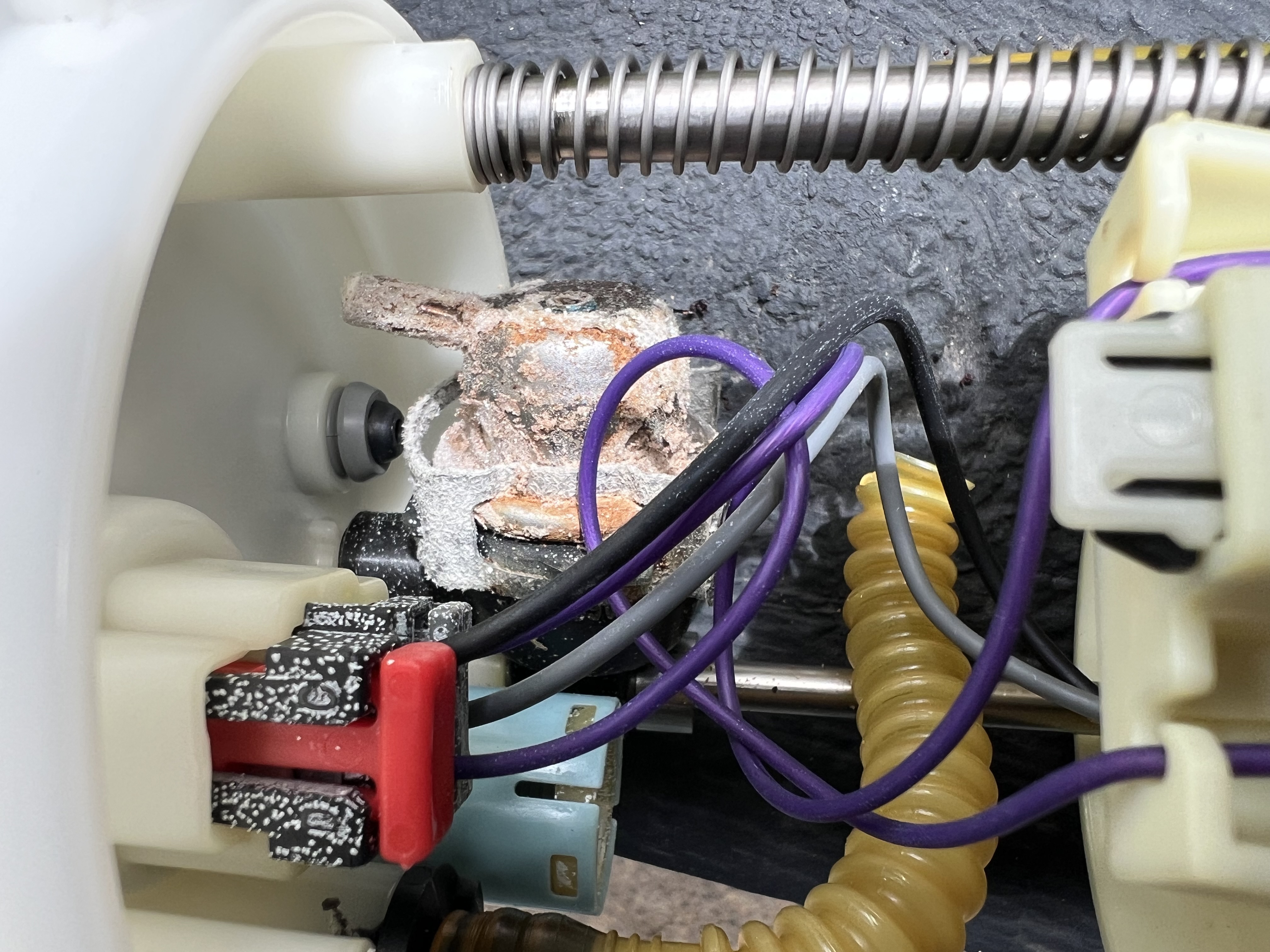

If cars have not been started or driven there is a high probability the fuel pumps will be bad.
Here is what a bad GMMG fuel pump looks like. (Hard plastic that falls apart when touched & corrosion on parts)
Fuel pump from Bobby Labonte Blackbird #38

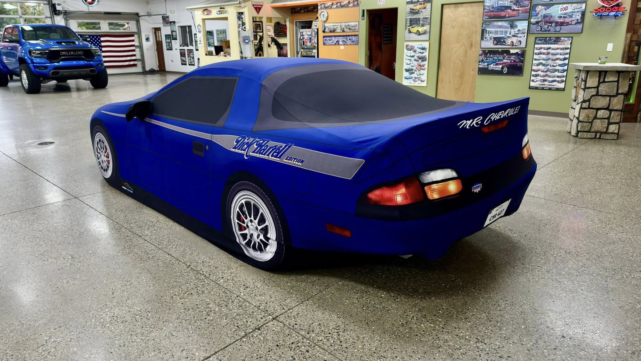

COVERING CARS: Here is a cool cover…… Nyle Wing – Dick Harell #2

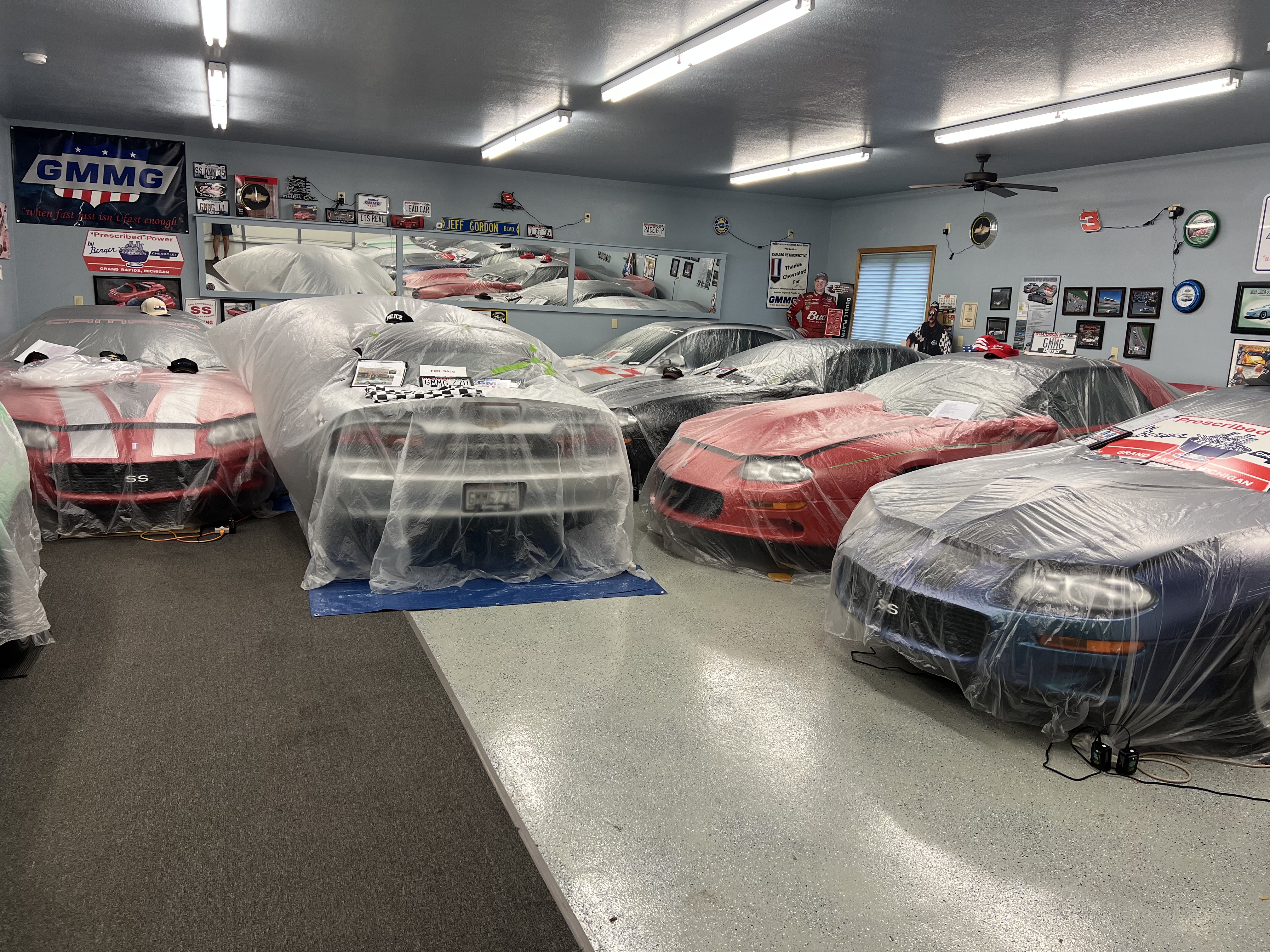

WINTER STORAGE & SHOWROOM - TEMPERATURE & HUMIDITY
My showroom is 100% climate controlled like a museum.
Very little air moves in the showroom & this minimizes dust.
Air conditioned, heated (I keep @ 50+ in winter), dehumidified, floor heat, 100% finished floors.
I always have a piece of rubber membrane roofing material between the tire & floor.

Years ago with metal gas tanks – I kept them full.
When plastic tanks came along I kept the gas level low. (see thread above for photos)
I have replaced 4 fuel pumps in 4th Gens. Everyone was corroded, dry & the lines hard, rotted & cracked.
Why?
GM Service techs say it is because the tanks are not full & air & fuel cause corrosion & hardening of anything rubber or plastic. OK, that makes sense to me.
What is the fix?
Keep tanks full?
I drive all the cars a few miles in spring & fall if they are not the 2 or I drive often in the summer.
I use Sea Foam in everything. I have not drained the tanks & will start this process this summer.

PAINT: I have hand detailed & ceramic coated most of the cars myself.

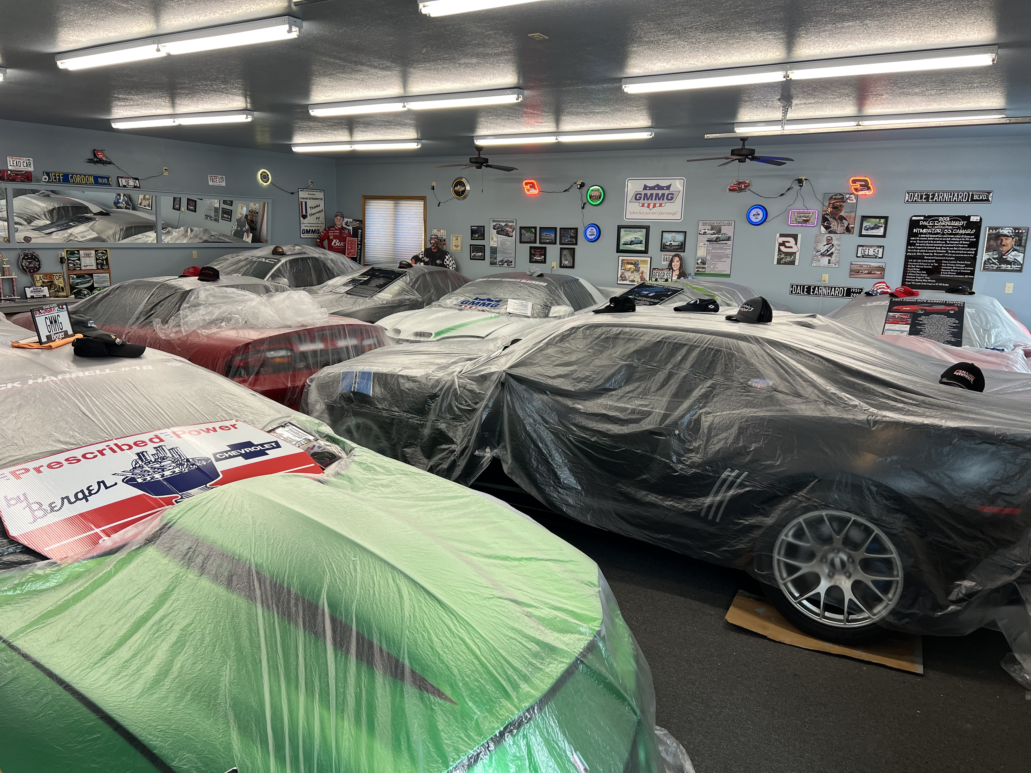

CAR COVERS:
I cover cars with painters’ plastic & DO NOT use ca covers.
Why? I can kind of see the cars & painters’ plastic has fewer small scratches & swirls in the paint.[/b]
